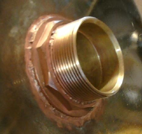

bikebimmonds wrote:@yhb - I had thought if the same process using the parts from jtm. did you use a seal ring between the two nuts? again ptfe tape seems like a cheapo solution. also, I'm asuming each nut goes on each side of the lid, posibly a silly question.
I have not used this method myself, it is far too easy for me, I like to make things much harder. Translated this means that I did not find these fittings until after I built my boiler, but if I had I would have used them. If I was making a connection now I would solder the top back-nut to the threaded connector, this would guarantee the external threads were sealed and all that would be required is an externally mounted gasket made from Silicone, EDPM or PTFE.
If you are concerned about the amount of brass in the connection ( I am not ) then the internal back-nut could be replaced with a stainless one, which are a standard, easily available item.

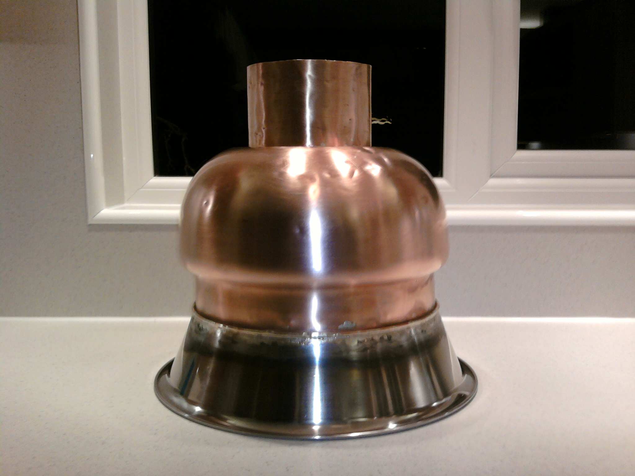

Let's kill a few miss-conceptions.
1. You can solder copper to stainless - you just need the correct flux and solder.
2. Pickling is a dead duck. You don't need to do it anyway but if you don't trust the brass there are better ways to deal with the problem.
Big compression fittings ARE a problem, you DO need a big spanner to compress the olive. I use a 4 foot sash cramp. After the olive has been tightened though you can undo it wrap it with thread tape and make a good seal with a 2 foot wrench.
You can make good compression seals onto stainless steel just by using a copper washer on both sides of the stainless and tightening well. The edge of the stainless hole cuts into the copper washer to make a good seal.
It is easy to solder a compression fitting into stainless steel to seal both the screw thread and the compression joint. The strength is in the compression and the seal is in the solder.
Off course you can also braze a compression joint for a PERMANENT fit. Bit harder to do but here is the evidence. This is a 54mm compression tank connector brazed into a stainless stock pot. It will NEVER come off again!!
Does not need to be a 50 litre one, there are 30's and 20's too. However, they are already sealed pressure vessels which is a good thing. This is a 30 litre keg over a small electric hotplate.

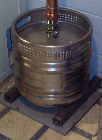

Myles,I admire your knowledge and skill at metalworking,and as always a well written and illustrated post.
For myself,the memories of trying to clean out the old keg still I built many years ago,made me plump for an urn.Simply lift the lid and use whatever it takes.
I know there is the possibility of including access ports to a keg,it would make the build more difficult though.
Having experienced one,I opted for the other,in the world of urn based stills my own is amateurish,people like YHB build works of art.
I am not trying to impress anyone,except with that which I produce.
I get your point about twist locking,that may mean some playing with gasket thickness,and may be a time consumer.
Regarding lid strength,my own is thin,and distorts downward not at all and carries a large column,more important I think is firm attachment of lid to boiler.
