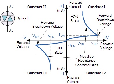

Its the Triac that is current controlled, not the Diac.
This may help.
http://www.electronics-tutorials.ws/power/diac.html
Re: Yet another power comtroller
Yes. That article confirms what I said above. The diac is voltage controlled and when it sees sufficient voltage it supplies current to the triac base.
However in the case of the device Anavrin scoped out, and I suspect all these encapsulated devices, the triac does not self latch and stay on for the full half cycle. So current ceases to be a control factor anywhere in the circuit. This would be why there is no switching hysteresis and they turn off at the same point they turn on without going lower than the switch on point. I assume the latching current is somehow set higher than the currents the device actually sees. Dunno really though. Just a logical guess without digging into the theory.
As can be clearly seen in his pics the triac lose conduction at the same critical voltage point on the falling edge of the half cycle as the rising edge. Whatever configuration of silicone they have used inside these devices seems somewhat novel as it does not behave in reality as the articles on standard device theory would suggest. This "triac" seems to be entirely base controlled and the "diac" appears to be doing more than providing a swich on pulse. It is holding the "triac" open while the voltage is high enough and turning it off when it drops. This suggests the "RC" circuit is more than a simple timed pulse circuit but instead acts as a variable voltage gate controlling what voltage the "diac" sees on a continuous basis. The quote marks are to highlight that we don't really know what is actually in those three functional positions. If I had to guess I would say the diac is the only one of the three that is behaving exactlly as expected.
Hence it could be inverted to clip the middle out instead of the leading and falling edge as the Chinese guy with the degree in power electronics has already done the hard work.
It's power control Jim but not as we know it.
Thank you Anavrin for taking the time to reveal that truth is stranger than theory.

My power electronics knowledge is getting a bit rusty but I do have a HNC in electrical/electronic engineering and have worked as an engineer for almost 20 years, so hopefully this will be understandable and clear up any confusion.
Phase angle controllers use a Triac to clip the leading edge of the cycles that make up an AC sign wave, a Triac is made up of two thyristors, one in each direction so it can conduct and clip both the positive and negative cycles, due to its design only the leading edge can be clipped, and once fired by applying suficiant voltage to its gate, it will conduct until the sign wave returns to zero volts, at this point it stops conducting.
A diac is basically two diodes, again one in each direction so it two can conduct both positive and negative cycles, as a semiconductor device, it will switch on very quickly and is ideal for triggering the gate of a Triac.
Across the AC input to a power controller there will be a Resistor and a Capacitor in series with the load, the Diac is connected at one end to a point in between the Resistor and Capacitor and at the other end to the gate of the Triac.
To explain how the circuit triggers the Triac to fire and control the point on the leading edge of the cycle, it's easiest to think of just the positive half cycle : As the voltage starts to increase the capacitor is charged through the resistor, at a certain point the capacitor voltage will be enough to forward bias one of the diodes in the Diac, at this point the Diac conducts and the charge stored in the capacitor discarges through the Diac to the gate of the thyristor in the Triac, the capacitor then discarges through the Triac once it's triggered, once the gate is open, the tyristor in the triac will conduct until the end of the cycle, the voltage of the load has to return to zero before the thyristor switches off, this is why only the leading edge can be controlled.
In order to control the power to the load the value of the resistor is changed, if it's increased, it will take longer for the capacitor to charge, delaying the point at which the Diac triggers the Triac, this time delay causes the Triac to clip more of the cycle and reduce the power available to the load.
Here's a simple diagram of a phase angle controller, you can see the resistor above the capacitor on the left, the Diac connecting between the capacitor and the gate of the Traic, they show a motor as the load but it can easily be a heating element instead
It's simple and it works, trying to do anymore isnt worth the effort.
