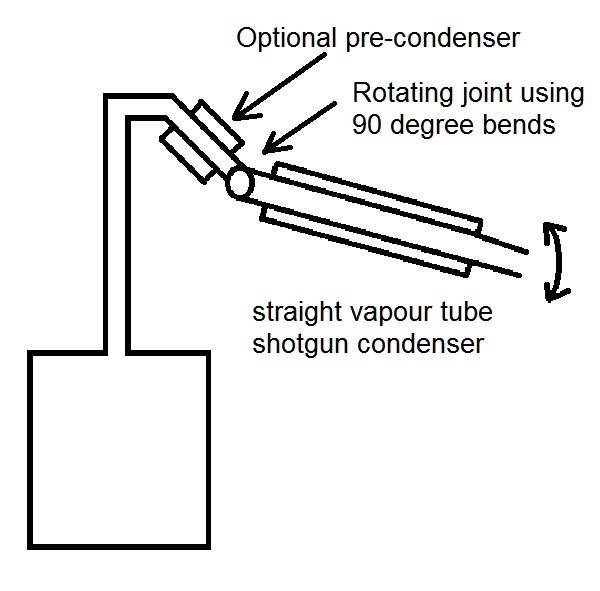

What is quite convenient after your tapered section is to fit a bend. Either a 45 or a 90, then a straight compression connector or union and then add a matching bend to the top of the condenser.
That way you can use the connector/union/triclamp as a rotating joint to set the condenser to any angle that is convenient.

That's exactly what I was going to do, after watching 10's of YouTube's I got the same idea.
