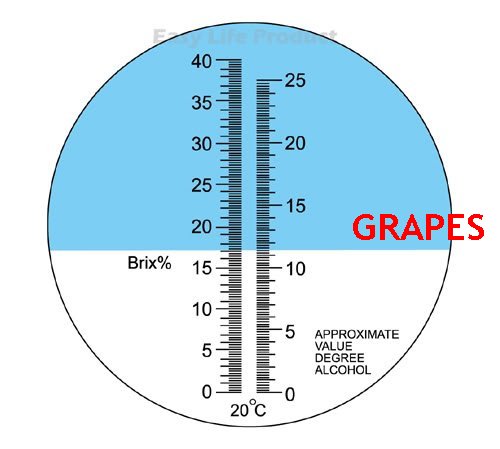

There are also different scales.
This is for sugar content- Grapes / fruit / fruit juice etc. The scale here has a finished % guide which is really handy to double check your maths when you start a brew.

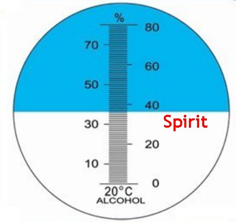

This one is for finished spirit.
